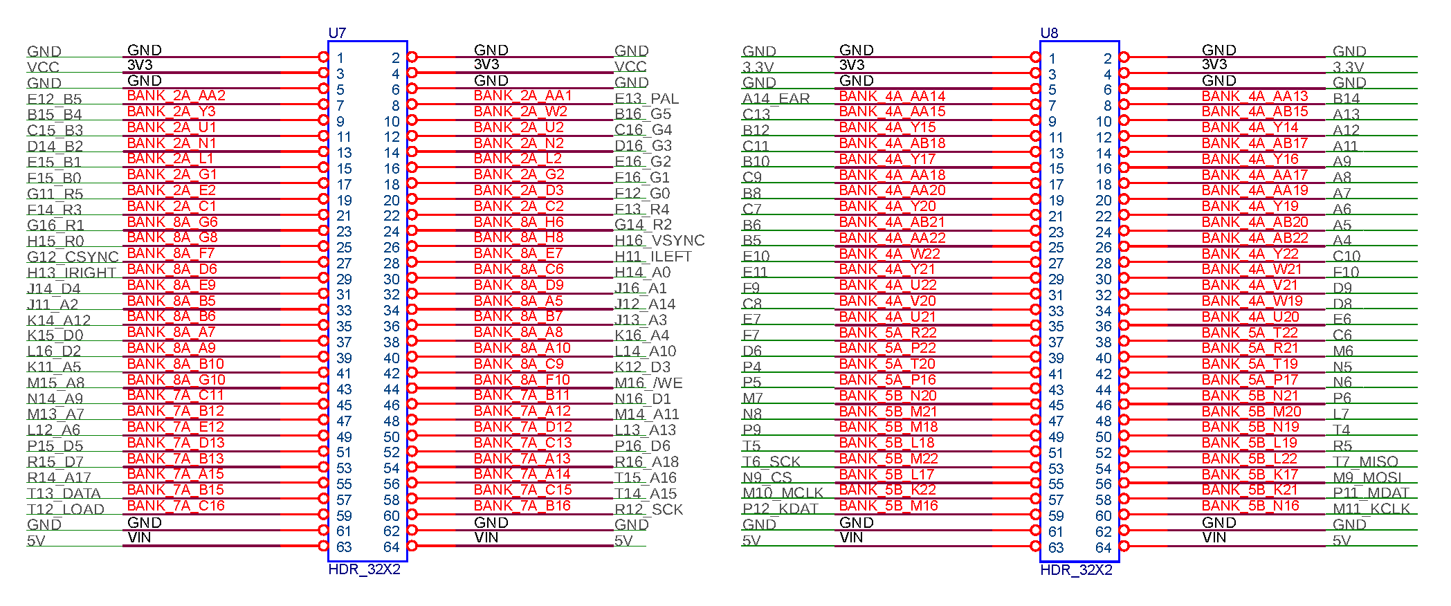

Hi ALL!!!
Has anyone already tried the configuration - https://github.com/benitoss/CycloneV_UnAmiga_v2 ?
(( Actual Scheme is now available in the post antoniovillena ))
I found some problems. The joysticks ports not work correctly.
The main problem is that the “load” and “shift” signals are mixed up.
The “load” signal PIN_C16 is the equivalent of T12_LOAD on the ZXDOS board.
The “shift” signal PIN_B16 is the equivalent of R12_SCK on the ZXDOS board.
In QUARTUS "Pin Planner" not correct
JOY_CLK PIN_C16 Output
JOY_DATA PIN_B15 Input
JOY_LOAD PIN_B16 Output
Another problem - bits in bytes are mixed up.
In Joy Port1 in schematic (or Port2 in Amiga)
UP is LEFT Mouse Button (Port2 in schematic (or Port1 in Amiga))
DOWN is RIGHT Mouse Button (Port2 in schematic (or Port1 in Amiga))
LEFT is UP
RIGHT is DOWN
FIRE1 is LEFT
FIRE2 is RIGHT
I have not tried to fix it yet. Maybe someone has already fixed it?

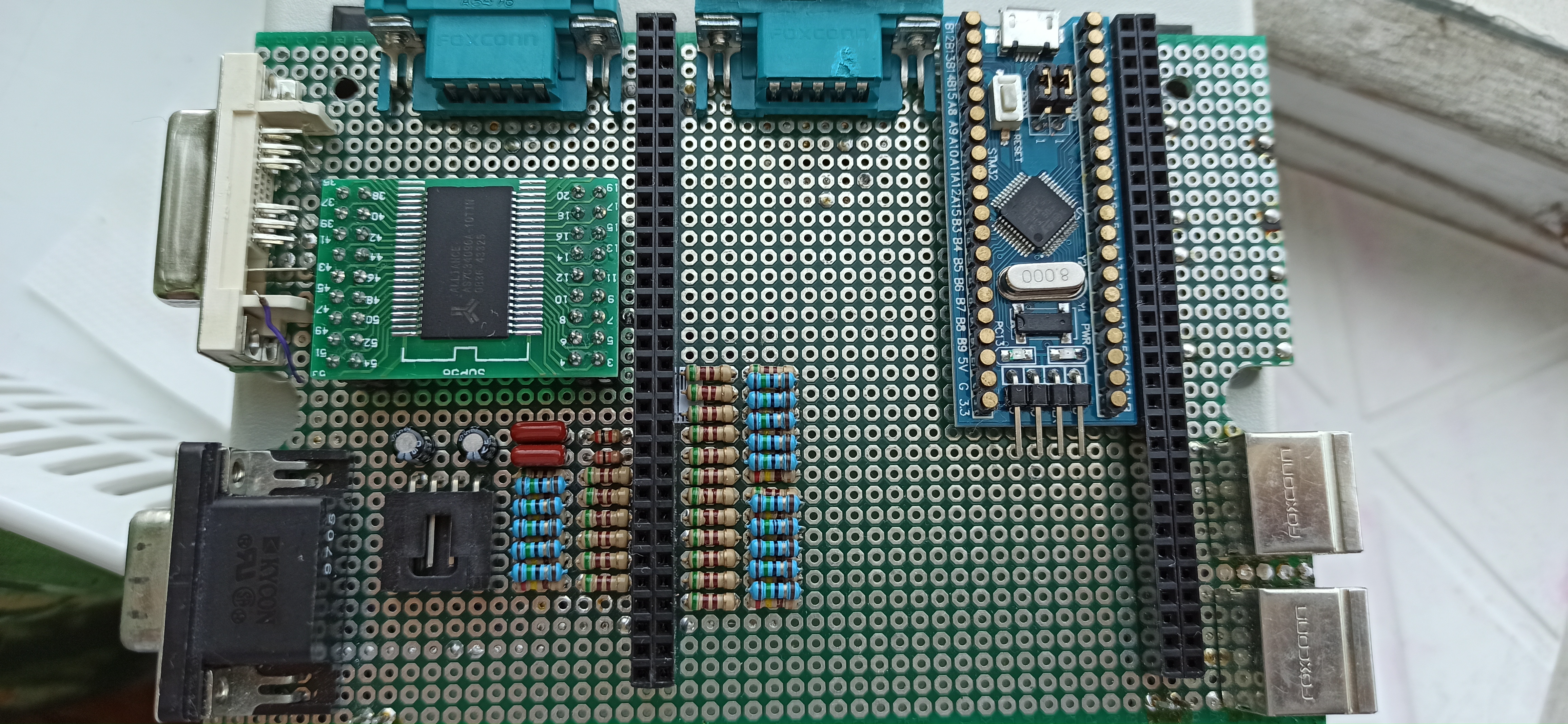

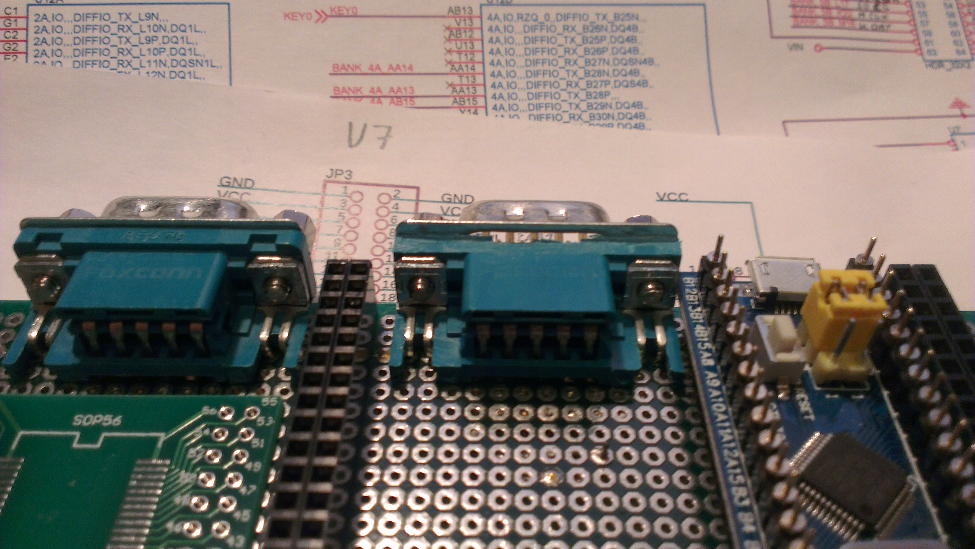

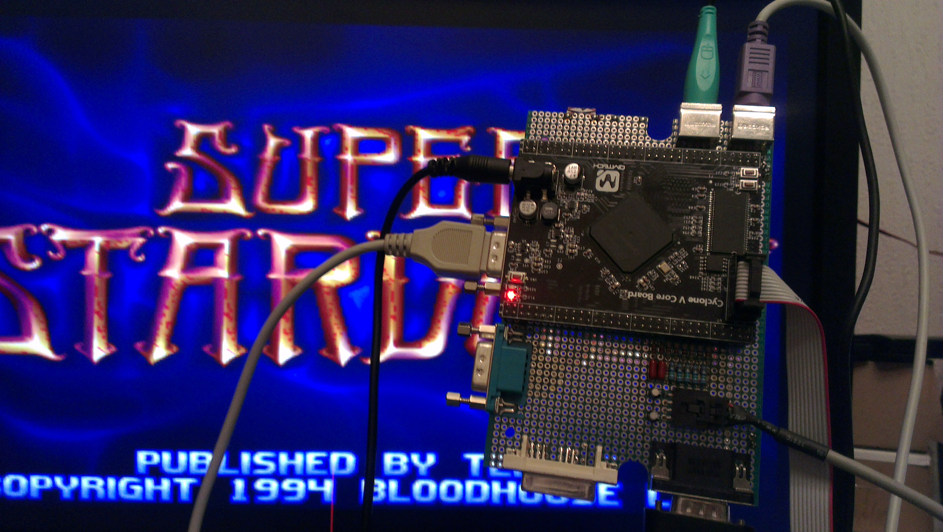

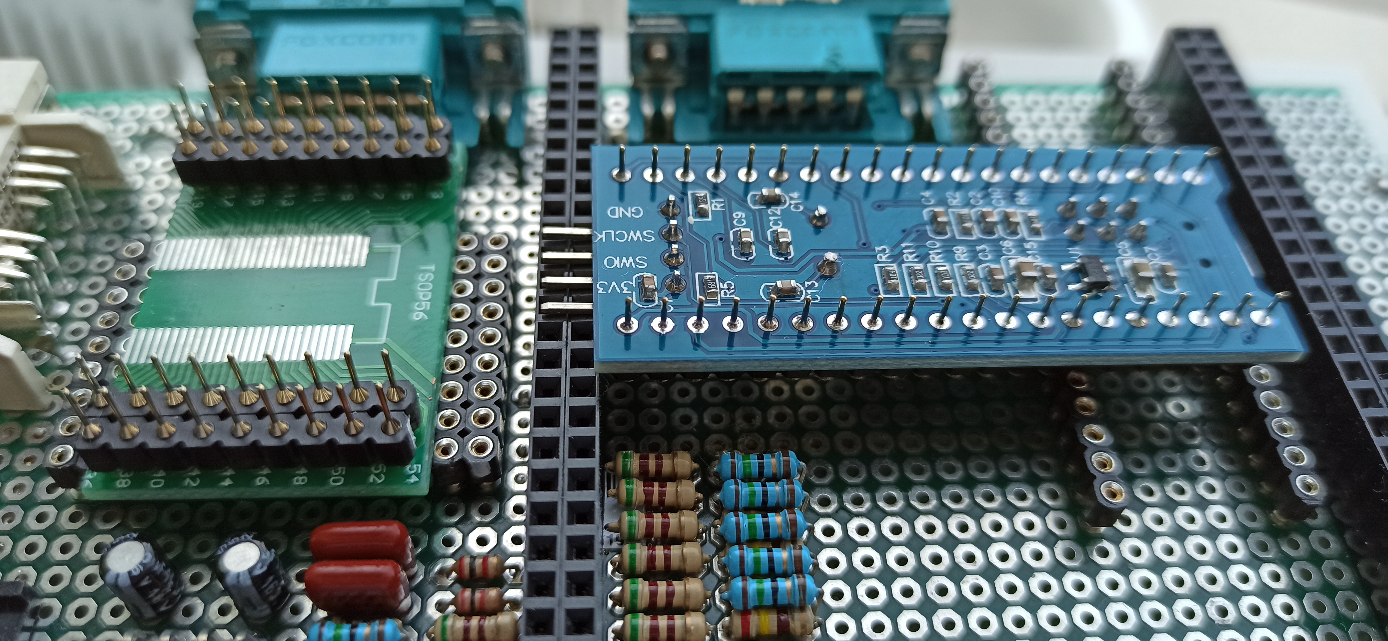

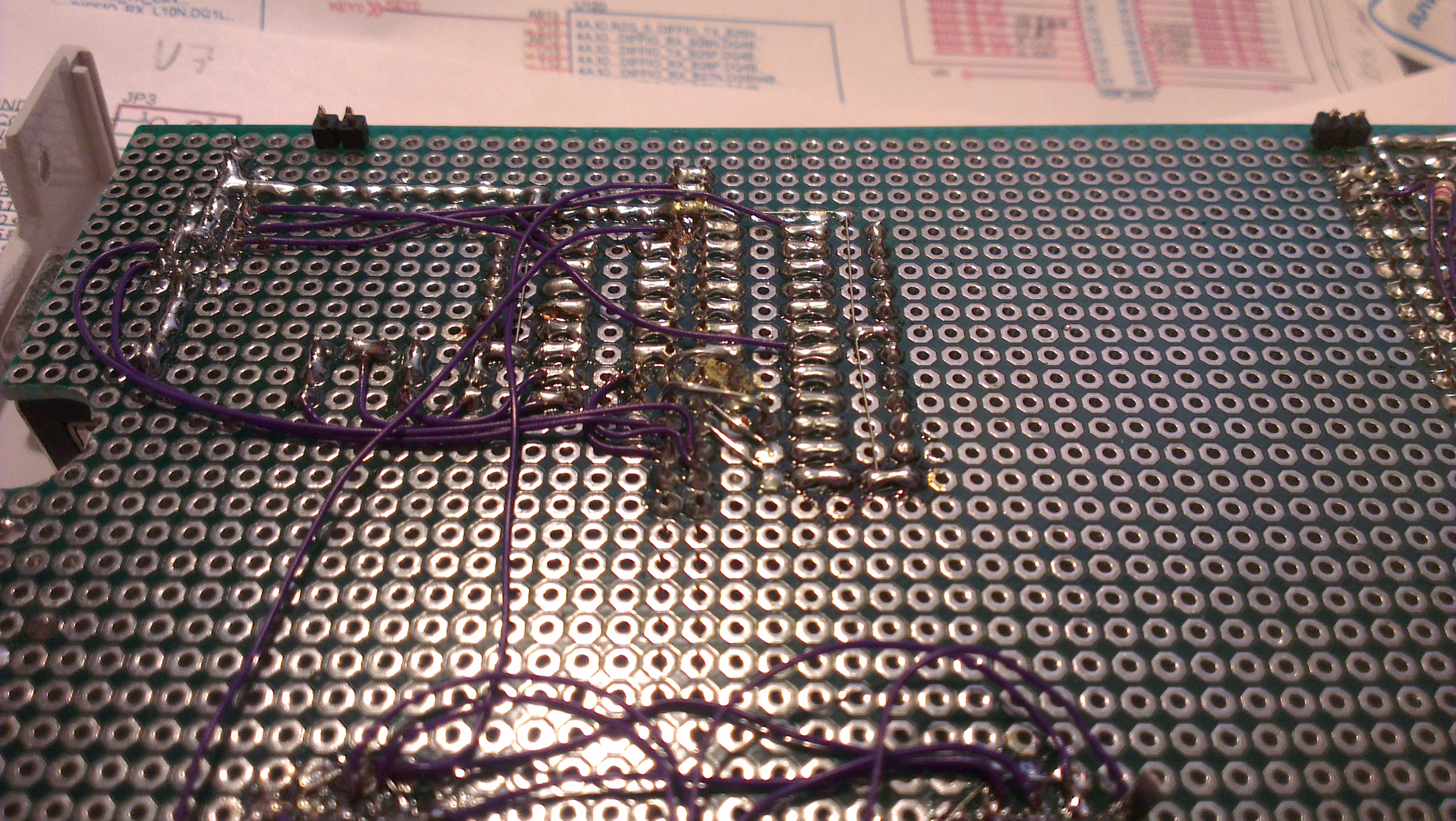

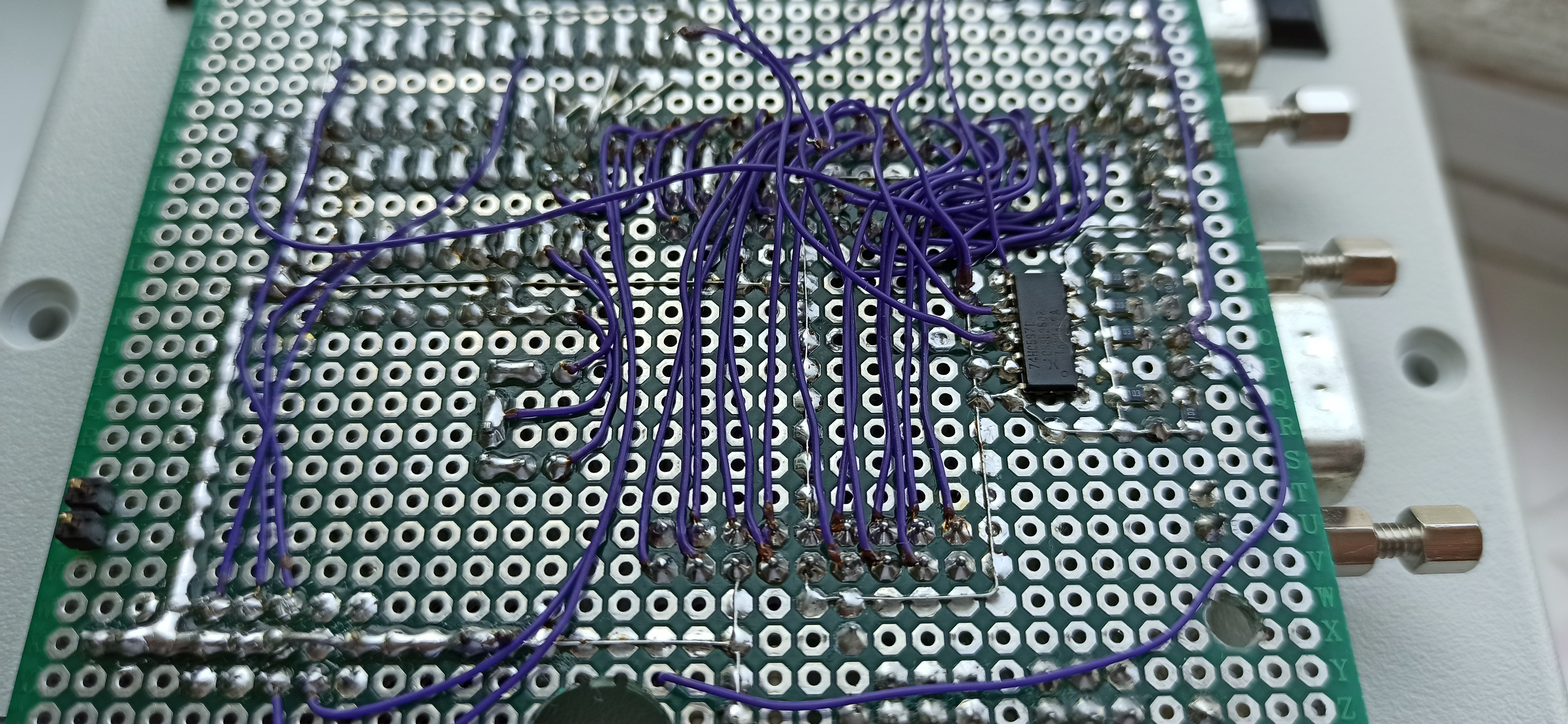

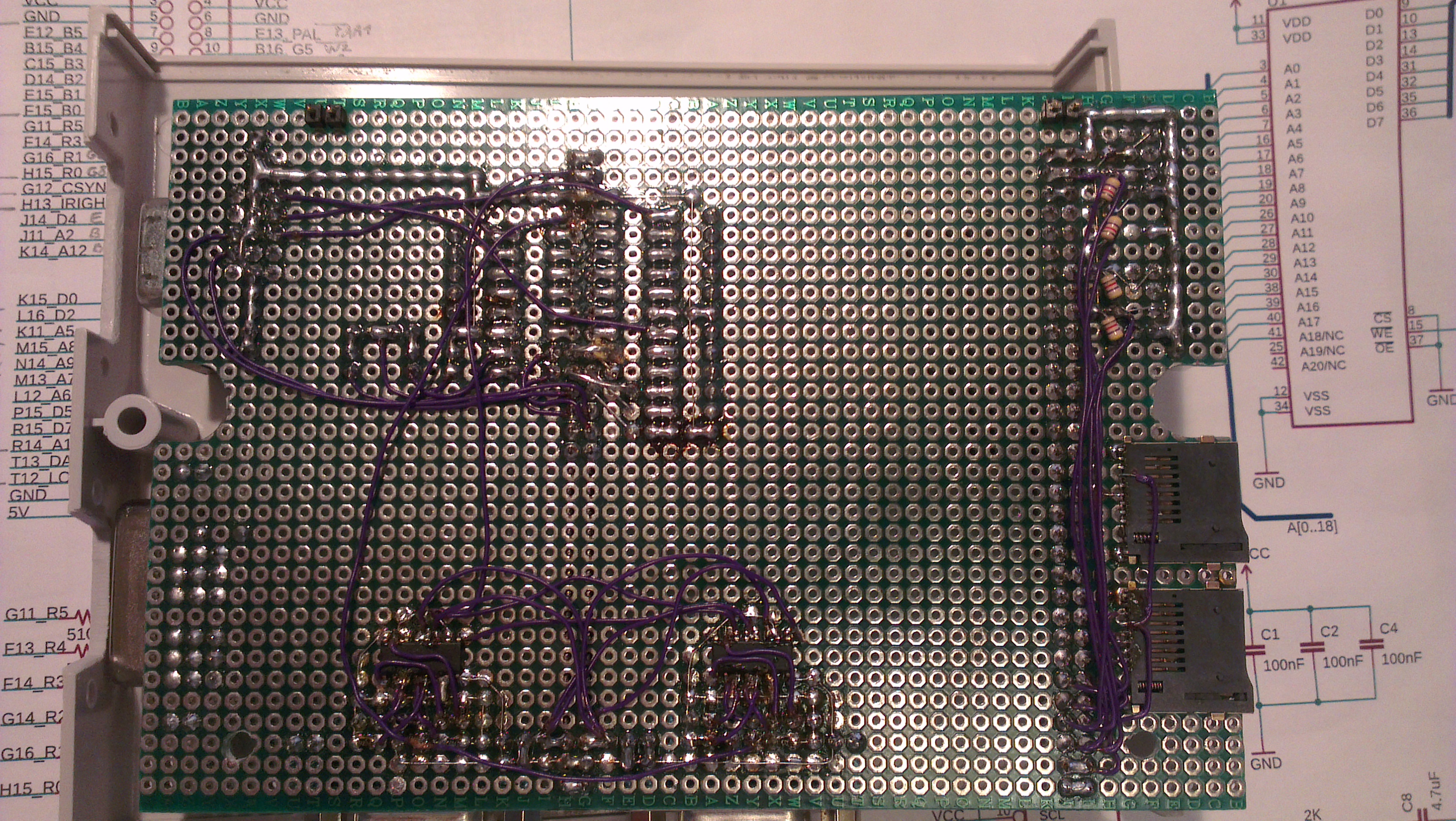

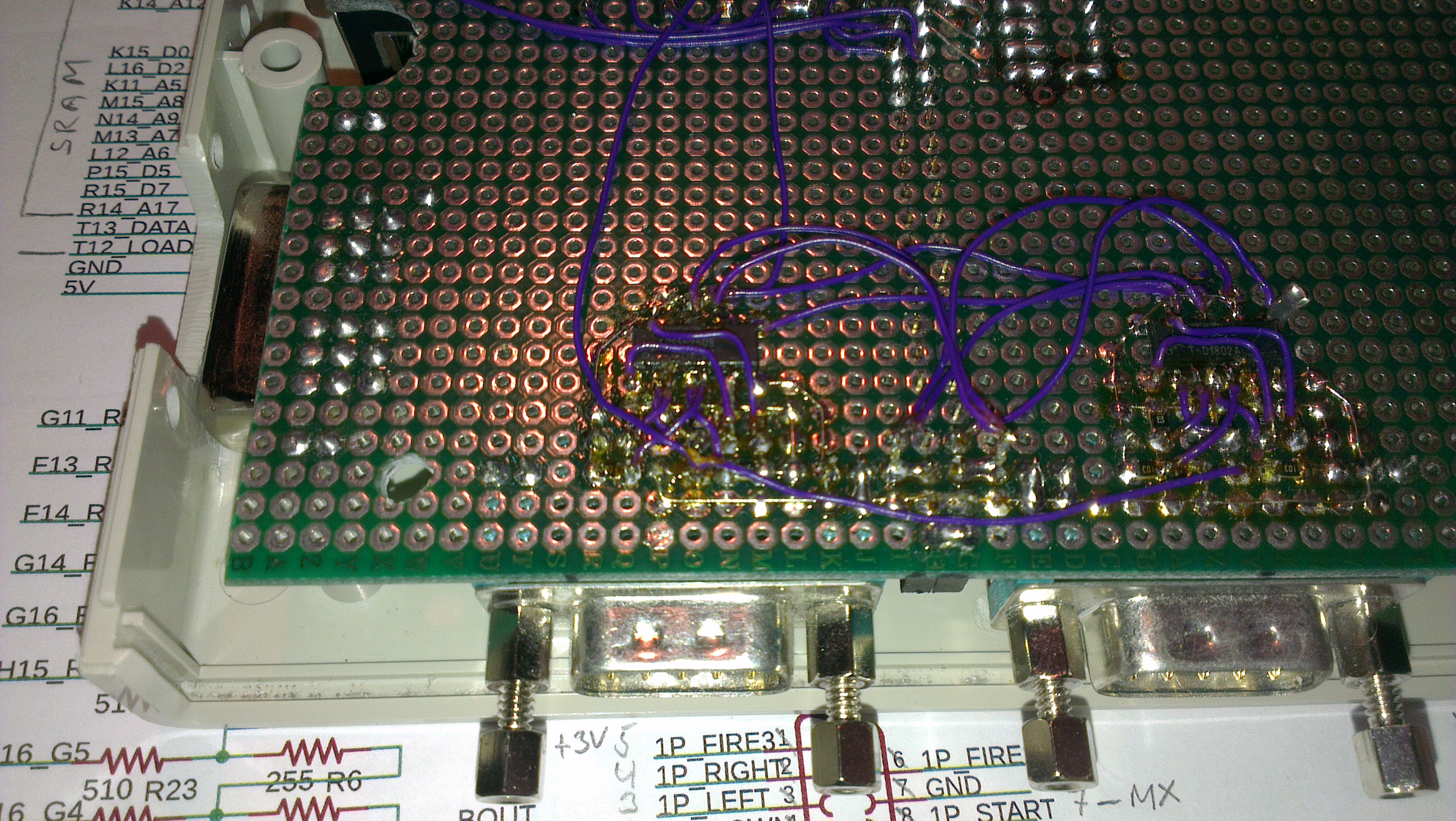

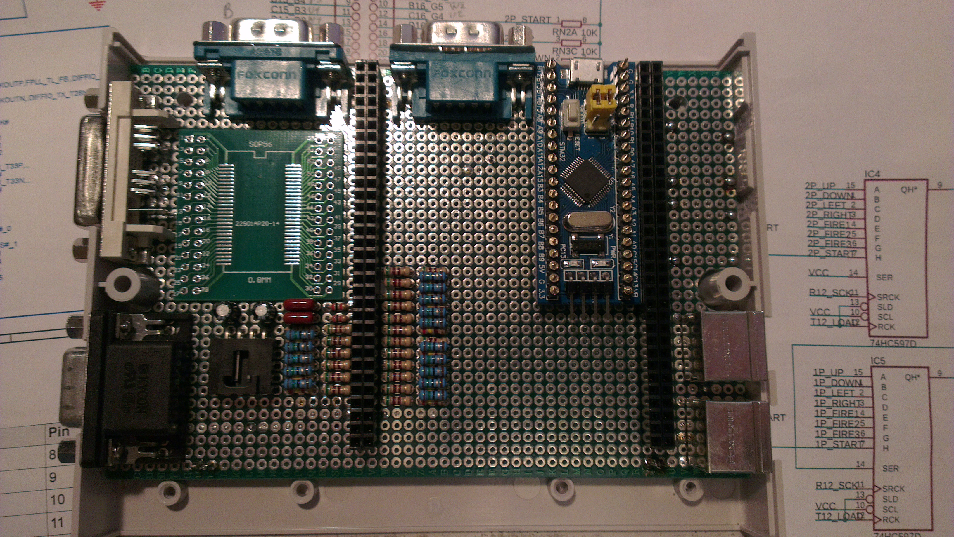

A few photos of my device.
- IMAG0245.jpg (2.09 MiB) Visto 167523 veces
- IMAG0246.jpg (2.36 MiB) Visto 167523 veces
- IMAG0247.jpg (1.66 MiB) Visto 167523 veces
- IMAG0248.jpg (2.64 MiB) Visto 167523 veces
- IMAG0249.jpg (2.44 MiB) Visto 167523 veces
- IMAG0251.jpg (2.45 MiB) Visto 167523 veces

I tried to quickly bring the port1 to life.
(Changes made in file joydecoder.v in project Board_Test)
5'd4 : joy1[5] <= joy_data; // 1p fire2
5'd5 : joy1[4] <= joy_data; // 1p fire1
5'd6 : joy1[3] <= joy_data; // 1p right
5'd7 : joy1[2] <= joy_data; // 1p left
5'd8 : joy1[1] <= joy_data; // 1p down
5'd9 : joy1[0] <= joy_data; // 1p up
Similar actions can be done in the Amiga configuration.

A few pictures.
- IMAG0289.jpg (1.43 MiB) Visto 165072 veces
- IMAG0296.jpg (2.09 MiB) Visto 165072 veces
- IMG_20200611_134122.jpg (2.82 MiB) Visto 165072 veces
- IMG_20200611_134901.jpg (3.65 MiB) Visto 165072 veces
- IMG_20200611_135300.jpg (3.06 MiB) Visto 165072 veces
- IMG_20200611_135404.jpg (3.42 MiB) Visto 165072 veces
